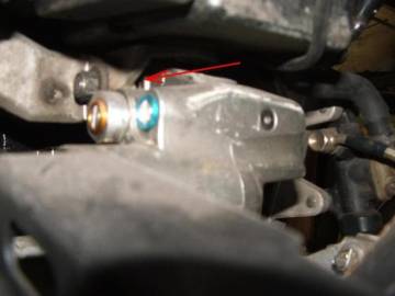

:!:You will need to round the lower shock mount so that it clears the suspension knuckle.:!:
All of the R6 shocks that can be used for this conversion look like this
2006-2008 Yamaha R6 Rear Shock
This image dipicts were you'll have to grind the shock slightly so it clears the knuckle.

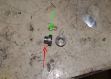

The spacers:
You need two of these spacers as the FZR shock is 10mm wider than the R6 and uses a 12mm bolt as opposed to a 10mm bolts.[ 10mm dia hole drilled through]FIXME. The green section needs to be 5mm wide, diameter doesn't really matter and can be anywhere from 14mm to 20mm. The red section should be just under 12mm dia and ~7mm long. For the FZR400 ignore the stepped down section on the left(red) as the FZR400 uses a 10mm bolt which is the same size as the R6, so you only need the green section.
Click To Enlarge

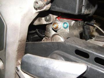

This is where they go
Click To EnlargeClick To Enlarge

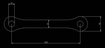

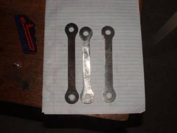

Dog bones:
~10mm short than the FZR dog bones, this raises the bike back near stock. 6mm thick.
Click To Enlarge
Stock on the left next to two new ones
