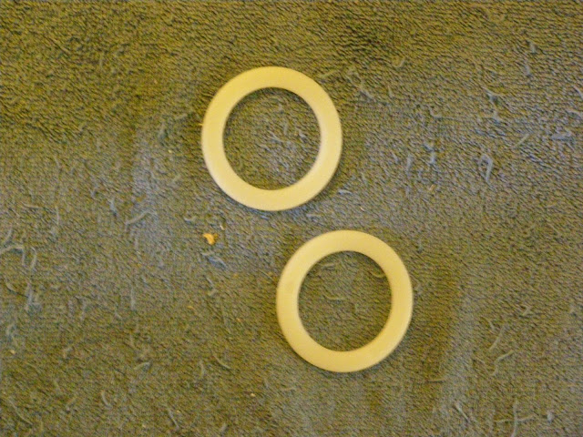

At my local hardware store I can buy these:
They are 50mm i.d. , 70mm o.d. and real close to 4mm thickness.
here's another view:

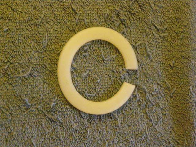

Dremel the inside diameter to 53mm, and use sidecut pliers to cut a section out:
If the shock is still mounted on the bike you can use a tie-down strap to fully compress the rear end and then use a couple of hose clamps across a couple of coils to compress the spring, undo the tie-down strap and you should have enough spring compression to slip the spacers in.
