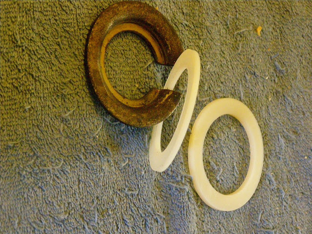

The OEM spring keepers are c-shaped. If you stack any up, just try to stagger the ends so the openings aren't lined up. It is my opinion that with the short stroke(45mm) compared to the spring length (153mm) that the twist issue really isn't an issue. Yamaha uses a nylon washer, bare, at the top of the stock FZR shock-I know mine had 17,000miles and 11 years on it and has no wear to speak of.tattysteve wrote:Is it OK to make the teflon spacer and the steel spacer as a 'c' section so that i can compress the springs and then slip them over the damper rod? Or is it better to do the job properly and make complete spacers - for which I will have to remove the spring completely, am i right in thinking that this is straightforward once the spring in compressed.
At my local hardware store I can buy these:
They are 50mm i.d. , 70mm o.d. and real close to 4mm thickness.
here's another view:
Dremel the inside diameter to 53mm, and use sidecut pliers to cut a section out:
If the shock is still mounted on the bike you can use a tie-down strap to fully compress the rear end and then use a couple of hose clamps across a couple of coils to compress the spring, undo the tie-down strap and you should have enough spring compression to slip the spacers in.

Thanks for the pics RR, i should be able to get onto that on Monday, and will let you know how I get on
im keen to get this done pretty soon so might just bite the bullet and get a set rather than wait for them to come across the Atlantic
C section is fine just make sure they are close to size round the rod (not rubbing) and the steel washer has the opening in the opposite direction to the teflon would make sense (YMMV as i have not done this with C's just completes in the past)

I got the spacers in and now get good sag values with the preload adjuster smack bang in the middle, perfect. CAdwell PArk becon on Thursday and then i think ill leave it for the year. I need to earn some money and it seems to just be raining here (England) all the time at the moment, so i my take my Aprillia to Europe!
