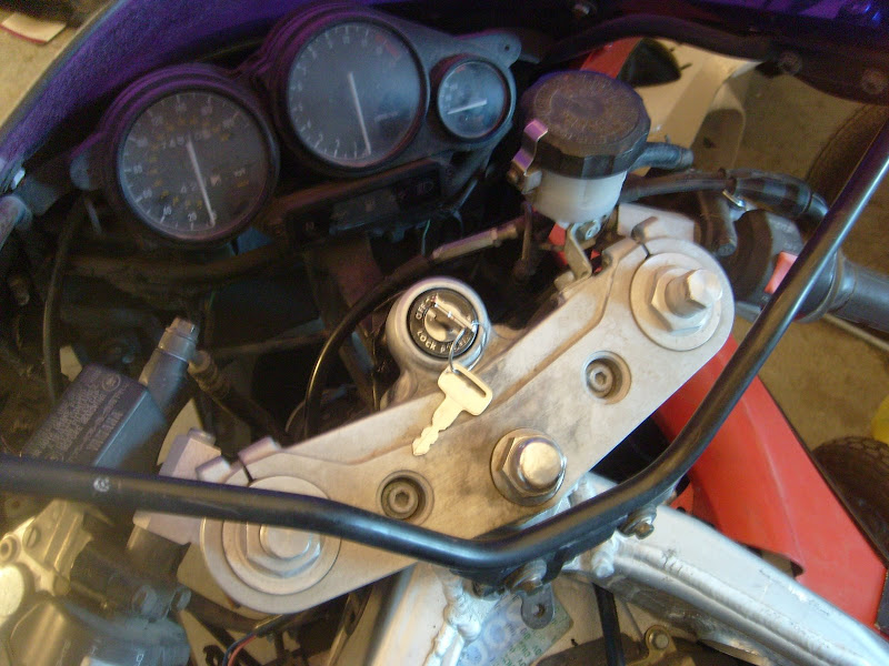

I removed all the decals. I've had a key made for it. I then tried jump starting it from my Jeep and it almost fired up. Cranked really strong and seems to have good compression (I will check that this coming weekend). I was also told the carbs were gummed up and would not open. Decided to pull them off and check them out. Turns out that the butterfly in one of the cards seized up. I've got another set of carbs coming soon so I figured lets dissect these a little more. So I separated the seized one and took it apart. Looked pretty clean inside. Noticed the needle had 6 setting options. The bike came with pods too so this leads me to believe there's a DynoJet Stage 3 Kit in them.
Anyway on to the pics....
The new keys

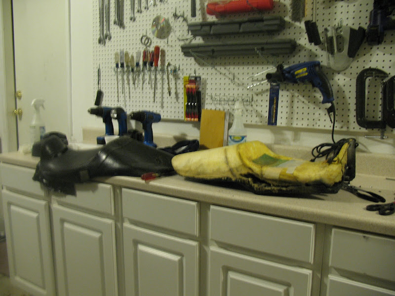

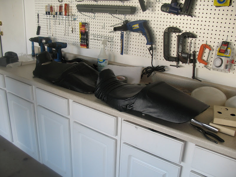

. Started staring at the pipe to see if there was any blue smoke...None. Only thing I noticed was a slight valve tick. I planned on doing the valves so I wasn't too surprised. But it was running and that was a major hurdle passed. I also scored a beat up Corbin seat, which I recovered (although it looks like crap).
