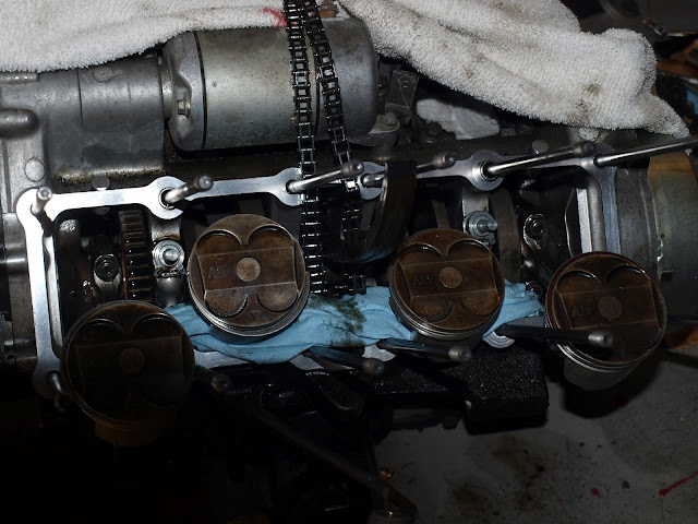

Some of y'all have seen my post at the other site, but I got to looking, and measuring and consulting with machinists, and.....
Yes, those ARE 4TV (YZF) pistons on 3he(FZR) rods.
And the same deck height (no change in rod length and same pin to crown height= no need for spacer)...
I know I'll get flamed about how the rods can't take it, the compression will be too high etc....
I betting on it working out.
In any case I'll be the guinea pig...should be back in the bike this weekend.

thatkid wrote:If it works I have a set of rods I'd like to send you!
Any decent automotive machine shop will have a rod hone.
The one I used uses a rod hone that indexes off the big end so that the small end is perfectly aligned with it. And 'reads' the pin for sizing. They need to take approximatley .018" out radially to fit the YZF pins.

The most important thing hasn't been mentioned.
NO spacer = the cam chain won't be over stressed (too tight) the chain tensioner will survive, and NOOOOOO damn adjustable cam gears needed.
The very best of luck, don't think you'll need it though.

yep shouldn't need adjustable cam gears, however the other two points are completely wrong. The cam chain is still loose when you use a base gasket for the 660 install and the tensioner will still apply the same force to the cam chain after being reset (mine went in a bunch of clicks after doing the 660 install and being reset). Could you show me an example of one not surviving using a base gasket?ramster wrote: NO spacer = the cam chain won't be over stressed (too tight) the chain tensioner will survive, and NOOOOOO damn adjustable cam gears needed.

(S)he might have meant the chain getting near the end of its life without you noticing (i.e. the tensioner wouldn't be maxed out, and you wouldn't notice the chain rattling around)... but even that sounds like a bit of a stretch.dru86 wrote:yep shouldn't need adjustable cam gears, however the other two points are completely wrong. The cam chain is still loose when you use a base gasket for the 660 install and the tensioner will still apply the same force to the cam chain after being reset (mine went in a bunch of clicks after doing the 660 install and being reset). Could you show me an example of one not surviving using a base gasket?
+1 on the cam gears. Adjustable or not, even getting those things on/off is a PITA.

Okay....
It's a runner.
It's not real happy with the jetting....that has yet to be worked out.
Comes off the bottom hard, hates steady state cruise and cleans up on wide open butterflies between 6500 and about 9k...then falls flat
Got the jet kit but no more time today.
I'll go up two steps on the mains, put the FP needles in and about halfway up and see what she does then................

Re: Ohh, Yes, he did...660 the easy(?) way
I've done three 10-15 miles jetting/break-in runs.
Got it running decent enough to take out for real today (still a couple transitional flat spots to deal with).
Hot as hell (mid 90°'s) I did a 120 mile loop-broken into four segments.
NO detonation on mid grade (89octane) which is pretty impressive at 13.2:1.
Temp gauge runs a third of the way up-actually a smidge lower than before(maybe just the new coolant)...no knocks, bangs or clanks.
