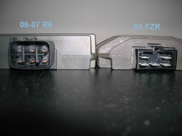

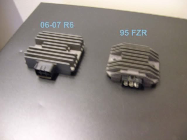

Just want to verify that the voltages are the same.
yes the top center is a dead pin according to the 07 service manual.sweekster wrote:I read somewhere the the top center pin on the 06+ was a dead pin. Don't know how much truth there is to that though.
Simple answer is YES and the proof is http://www.saltmine.org.uk/fzr/vr.htmlgre3nskeeper wrote:yes the top center is a dead pin according to the 07 service manual.sweekster wrote:I read somewhere the the top center pin on the 06+ was a dead pin. Don't know how much truth there is to that though.
My question is will they regulate voltage the same?
gre3nskeeper wrote:Confirmed. wired it up today and took it for a 30 mile ride. Recharged the battery fine.
