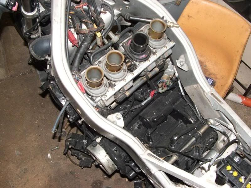

I'm running yzf600 carbs on my fzr660, using a fzr600 airbox with the holes enlarged to take the yzf600 boots. The snorkel is also trimed. The TPS is hooked up too. It has great pull form about 4.5K revs to redline however need to sort out the bottom end.
This is the current jetting with a K&N and factorypro stage 1 jetkit:
128 mains
Needle on position 3 with washer underneath
stock float high (needs to be lowered to lean out bottom end)
mixture screws and 3.5(also needs to be leaned out)
Having coolant run through the carbs is unnecessary, it's going to heat up the carbs not cool them which is not what you want.
fzr660/400: fzr400 3en1 frame, 3en2 swinger, custom single seat subframe, fzr660 motor conversion, APE adjustable cam gears, full D&D 4-2-1 exhaust, falicon clutch basket, ignitech ignition, R6 front end with tz250 wheel, ohlins shock, storz steering damper, tzr250 rear wheel.

dru86 wrote: I'm running yzf600 carbs on my fzr660, using a fzr600 airbox with the holes enlarged to take the yzf600 boots. The snorkel is also trimed. The TPS is hooked up too. It has great pull form about 4.5K revs to redline however need to sort out the bottom end.
128 mains

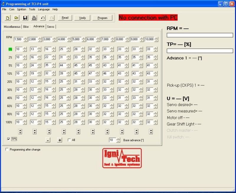

The TPS changes the ignition timing depend on how much throttle you're giving it, It's a function of the ignition unit. I'm able to run the TPS as I have a aftermarket ignition unit which has the TPS function incorporated. The TPS makes a big difference in how responsive the engine is to changes in throttle position.
Here's an old timing map that i was running, the % on the side is how much the throttle is open.
weighs 166kg wet (25kg lighter than my stock fzr600).

dru86 wrote:The TPS changes the ignition timing depend on how much throttle you're giving it, It's a function of the ignition unit. I'm able to run the TPS as I have a aftermarket ignition unit which has the TPS function incorporated. The TPS makes a big difference in how responsive the engine is to changes in throttle position.
Hee Hee ,
I thought if i went fishhing I would get the correct answer, thanks Drew.
