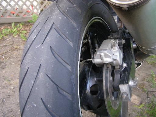

Well, I got my Avon AV56 Storm 160/60zr18 installed last saturday and MAN does it grip
went for several rides back and forth on Patterson Rd. including one with a 99' vette chasing behind me.
if I lean anymore, I will be sideway...
(I hate chicken strips)
another crappy cell pic

The BT-014s do wear the center down way too quickly. Let us know how the Avon does over time Shred.
Make sure you scrub the tire all the way or it doesn't count....
Re: what rear tire?
ragedigital wrote:The BT-014s do wear the center down way too quickly. Let us know how the Avon does over time Shred.
Mine's doing great...7500+ miles.
and, I was gonna say......If you hate chicken strips, Shred, why you got 'em?

these thiner tires have more of a radiaus to them.
I was looking at my buddies R1 and I was like that rear tire is cheating because its tread doesnt go as far down the sidewalls as mine.
I want someone to show me pics of there fzr with no chicken strips...with stock rim.... C:
i cant do no 90 degree lean angle like rossi!

haha! Rage! you still have chicken strips! its called a sidewall! thats awesome dude! and shred, i got less chicken strips on mine, and i am old, with a 1 year old daughter and only ride to work when i get a chance! haha, just kidding, ride to where you are comfortable. you will learn a bit better form, and all of a sudden you have rage chicken strips! you will be surprised. always be learning, when you stop learning, you stop growing...

thats not the problem...
i can lean. the radious on my tire doesnt allow for no chicken strips. I would literly have to be sliding on the exhaust.

I think you would be surprised how easily those "chicken strips" would disappear with a couple of Track Days.shredex wrote:i can lean. the radious on my tire doesnt allow for no chicken strips. I would literly have to be sliding on the exhaust.
LEAN IT!!!
(I should have my head off the bike more, so the bike can be more upright, but I get tired quickly though. It's hard to do that all day.)

shredex wrote:Well, I got my Avon AV56 Storm 160/60zr18 installed
shredex wrote:I want someone to show me pics of there fzr with no chicken strips...with stock rim.... C:
A) If you bought the CORRECT size tire, the profile would likely be better. http://www.avon-tyres.co.uk/motorcycle/storm-st -Note, Avon themselves says that the 160/60-18 should be mounted on a 4.25"-5.00" rim.shredex wrote:the radious on my tire doesnt allow for no chicken strips.
B) The tire shouldn't be maintaining it's static profile when you are riding. If it DOES, your air pressure is too high.
C) I'm an old man, but here's MY Avon 150/70-18 (proper size for stock rim..)
D) if the exhaust drags, twist your mid-pipe and get that can tucked up a bit higher-yours hangs as low as a midget pornstar

I have the right air pressure.
it was like 32 front 34 rear...I think.
I had the guy installing it put the right air pressure in for the style riding I do which was the same as him.
I was actually going to get the 150 but I allready had the 160 on order so I couldnt change it.
im just glad it fits and I have no problems with it so far.
there is like 1/8" space from the tire to chain and tire to caliper mount. scary. I thought the tire would change shape in corners or something and hit but it doesnt and im happy with it.

for once i have to agree with shredex, my bt-014's won't let me get rid of all my chicken strips, and i have even hit the exhaust, and scraped the body work on the pavement, scared the shit out of me when i lost traction.shredex wrote:thats not the problem...
