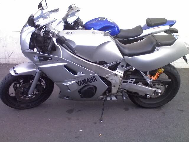

I saw it at home depot today and I took a quick pic with my cell. What is it? It's a dual round headlight model, but it doesn't look like my 89. The tank fairing looks like a stock FZR tank fairing, but it doesn't fit the frame right, and the swingarm is different. I actually like this frame better than mine..

The swingarm is 3tj (400) style swing arm, the rear sub frame seems to be bolt on square section so 400 againmatch417 wrote:I saw it at home depot today and I took a quick pic with my cell. What is it? It's a dual round headlight model, but it doesn't look like my 89. The tank fairing looks like a stock FZR tank fairing, but it doesn't fit the frame right, and the swingarm is different. I actually like this frame better than mine..

Hi George
That's an FZR 400 1WG '87 model (the earlier models). If i could see the swingarm, i would be able to tell you if it's from 3TJ or the latest 1WG. 3TJ has the rear brake caliper beneath the swingarm, and a 4.50"x17" rim, while the latest 1WG has the caliper above it, and the rim is 4.00"x18"
Oh...and it's got a 600cc engine on. Take a good look of the left engine cover and you'll see what i mean.

It's a 1990 spec US fzr400(1wg) it shares the same swingarm as the 3en2.
The cover does suggest that it's got a 600 motor in it although it could just be an aftermarket cover.csofos wrote: Oh...and it's got a 600cc engine on. Take a good look of the left engine cover and you'll see what i mean.
