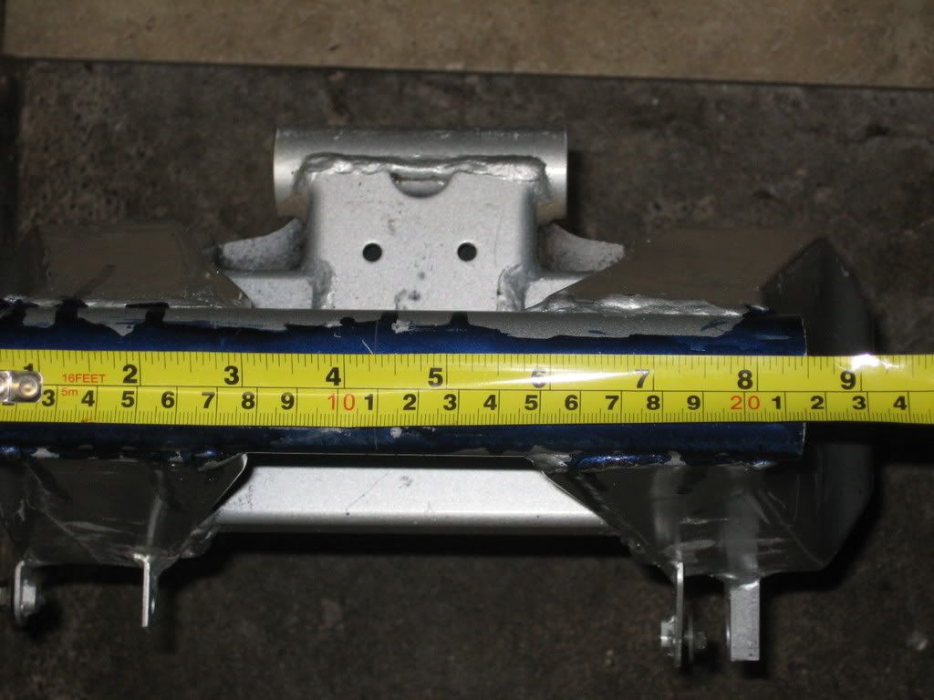

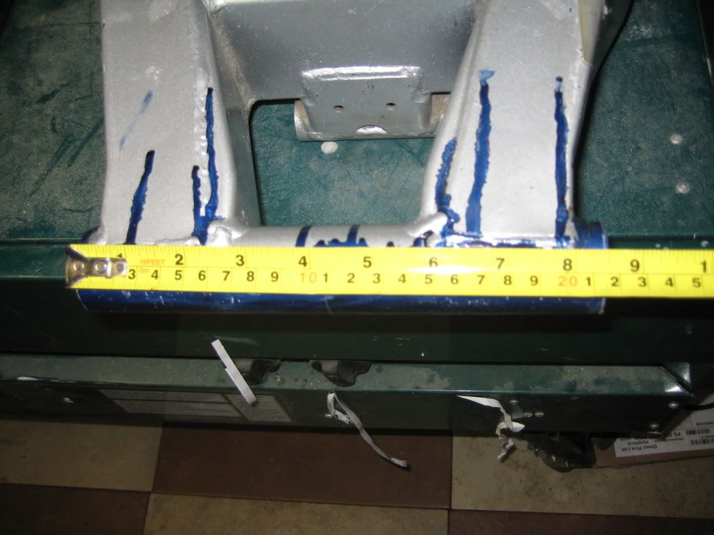

Well i was in the garage messing around , decided let me measure up my swingarm and see what i can come up with, popped the bearings out pulled out the hacksaw and this is what i came out with
that damn thing measures out to 8.5inches across all the way around but one side seams to stick out further then the other .. SOmeone help?lol
i hope i didnt Fawk it up

Question...how many times did you measure BEFORE you cut? How exactly did you go about measuring? You can probably shave a few mils off one side (or both) to get it to even out. If i were in your shoes I wouldn't do anything else until I can get that YZF swingarm together next to an FZR swingarm to double check..and double check some more.
Duane... Bike: 1994 Yamaha FZR 1000 EXUP
Factory Pro Stage 1 Jetting | K&N Filter | Corbin Seat | ProTek Keyless Gas Cap | GSXR Mirrors My Thread Cage:
8.47-8.50 is the total distance you want. i think 9.25 was the over all lenght of the yzf600r swingarm. when i did mine i measured centered 1st, marked it and measured out 3 times to check it for trueness. i think i cut .375" off each side and then i grinded a few mills off yet also since it fit kinda snugg in my frame. i didnt use the stupid washers either then mounting it in the frame but with everything together yo ushould be at 8.75 with dust caps and washers i belive.
So you didn't use your washers for the pivot bushings ? And when you cut the pivots where they identical on both sides or did one have alil more then the other ? I measured it out from center with digital needle reader .375 out.

are you sure you are not seeing the shittyness of the welds playing a trick on you? you might have to grind them down also for the dust caps to fit on. you can use washers, i just chose not to since i didnt have a rubber mallet or an extra set of hands to help shove the arm in.
abs600fzrr wrote:are you sure you are not seeing the shittyness of the welds playing a trick on you? you might have to grind them down also for the dust caps to fit on. you can use washers, i just chose not to since i didnt have a rubber mallet or an extra set of hands to help shove the arm in.
i think that was it<the shittyness of the welds playing a trick on me> but one side is still shorter then other not sure but i know i measured from center also , i grinded down the bushing caps and grinded the welds a little bit ..with the caps on it just a hair under 8.75 , i need bearings and a front sprocket and im ready to install this bitch unless somone buys it .b4

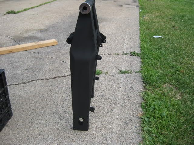

man i could only find one axle with one spacer no wheel collars 19.99 for the axle 10 shipping .. like i dont need 3-4 axles ya know , i painted my swingarm to see what it gonna look like flat black , im going to sand it down and spray it a black matte finish so i has more of a satin sheen ..all i need to order is my bearings and this puppy ready to bolt on after i bore out the insides of the pivots . with a flack black finish pics.. its still alil dull for my taste ..

im at work so i cant view pics...piss me off sounds like its comming together. i am so sick of my build...mainly its the figuring out shit that gets to me.
