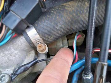

Step 1 break off the lead on the bottom for the LED. Temp switch: Blue(+)/Black(-) on the neck. Tap into the blue using the razor knife to cut a smaller cylinder of the plastic off of the copper. (the black is always grounded, regardless of the switch being open or closed) and run a line to the rocker switch(center, or LOAD) on whatever side you mount it on. Cover the line in rubber or vinyl tape. If you use the 12g spade on the end (you make have to fold the bare copper a few times before crimping) it will slide right over, making your connection from blue wire → center of rocker switch.

Now: For pictures in order.
