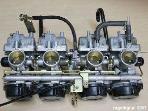

Idle Adjustment
In this photo, you can clearly see the idle adjust screw - top left. It has the flex area covered in the black plastic sheathing.
*Note: These are Cali carbs and have 2 tubes shown on the right that may or may not be like your bike. I removed and plugged those holes.
Turning the idle adjust screw clockwise will increase idle RPM's and counter clockwise will decrease rpms
