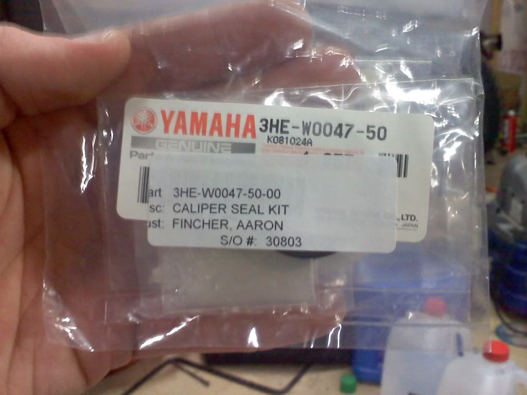

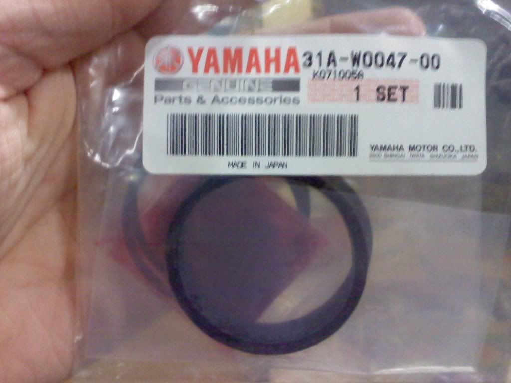

One front caliper kit for the 4 piston front calipers:

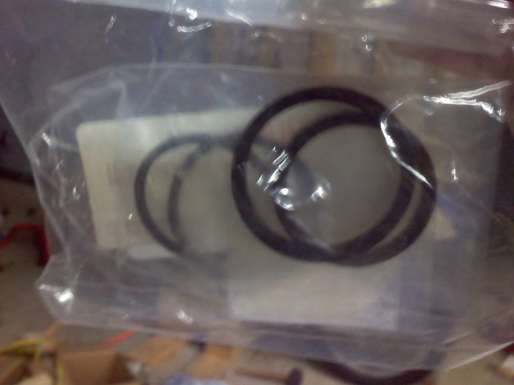

I had to spread them out so you could see in this pic but you have 2 oil seals (1 large 1 small) and 2 dust seals (1 large 1 small) in this kit. Means you'll need 2 per caliper.
Which made me realize I need to order 2 more front caliper kits. banghead
On the rear, however, one kit does the entire caliper.
You might not be able to see it all that well but the rear kit has 2 oil seals and 2 dust seals.
