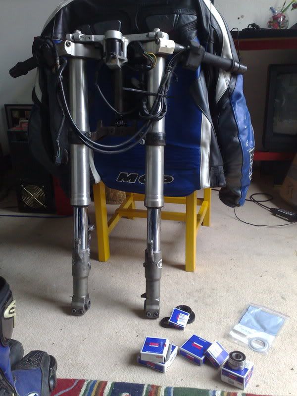

haunter wrote:the YZF750 and 91+ FZR 1000 USD's need the steering stem swapped and the steering bump stomps ground down and use the stock speedo
Sorry, but that isn't true.
The FZR400, FZR600 and the 91 FZR1000, all have the same bearing dimensions and nut dimensions.
From left to right: FZR400 stem, FZR600 stem, 91 FZR1000 stem.
Ik got a complete front end from a rear-ended FZR1000. This included, wheel, disks, clipons, triple tree, etc, etc.
The FZR400 and FZR600 dubbel piston brake calipers will fit on the 320mm disks and the forks. All i had to do was modify the steering stops om my 89 FZR400, but that was very easy. Just drilled a hole into the notch that is already there, theaded it, and added two bolts. Now ik have an adjustable steering stops.
Right the FZR400/600 wheel with 295mm disks, and left the FZR1000 front wheel with 320mm Disks.
Quite a difference.
The biggest difference was the stance of the bike, and how wel it handels in fast corners. Als braking (now you have a 120 tire) is amazing.
Everything just clears in the cockpit
The big advantage of the 320mm FZR1000 disks is that you can also mount Ducati/Aprillia Brembo disks.
All in all, including getting fresh bearings, replacing oil seals etc, etc it took me just under 2 days to do the entire swap.
