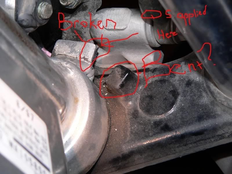

Ian,ian wrote:Do you have to do the R6 tail swap in order to do the tank swap, or is it vice versa? I want to have a metal tank because my tank cover is cracked from my left clip-on smacking into it ever so often (the restrictor on the neck broke somewhat in my Feb accident).
to replace the lock stop is an easy weld back if it is the one on the frame tube (mine was buckled heated it & tacked it back on. If you mean the one on the triple tree you can drill and tap where the old one was and use a bolt (have to do that sometimes on specials )
The fix will save you getting a broken thumb...... (do not ask how I know !!!)

yamaha_george wrote:Ian,ian wrote:Do you have to do the R6 tail swap in order to do the tank swap, or is it vice versa? I want to have a metal tank because my tank cover is cracked from my left clip-on smacking into it ever so often (the restrictor on the neck broke somewhat in my Feb accident).
It's the lock stop on the frame tube (I believe, here is a picture).
I don't have the piece that broke off. Am I going to have to take the whole front end off for this, or is there an easier way? I talked to my uncle (a fabricating semi-genius) about it and he recommended just grinding down a piece of metal to about the same shape and size of what I need and then JB Welding it. I'm just wary that it might not hold...

Ian,ian wrote:yamaha_george wrote:Ian,ian wrote:Do you have to do the R6 tail swap in order to do the tank swap, or is it vice versa? I want to have a metal tank because my tank cover is cracked from my left clip-on smacking into it ever so often (the restrictor on the neck broke somewhat in my Feb accident).
sorry I missed the continuation of this thread. BUMPing it got my attention :-}
Yes that bit is on the frame.
no JB weld will be unlikely to hold it
Take off the front fairing & lights, remove the battery & CDI and have a pal weld on a new piece ( the high frequency of stick welding/ will mess with both those items)
or
apply heat and bend the old piece down
DO NOT bend without heat because you will fatigue the metal & it will snap right off !!
When applying the heat use a sharply focussed flame BECAUSE you can set fire to the seal on the bottom off the triple tree.
I personally would heat from the main frame side rather than from in front keeping the flame well away from anything that just may catch fire (air box etc)
