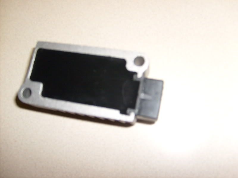

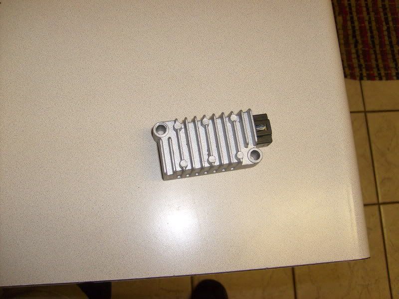

So I ran some tests... I did the regulator test and came up with about 45V across the all of them, ok so its bad, but it looks new??? There’s a small crack on the back I don’t know if you can see it in the pics. I’m not an electrical noob, but I don’t get the reason the meter needs to be set to AC volts when doing this test. Does the generator produce AC voltage? Or is it a typo in the right up?
I also did the Stator test and came up with about .4 to .5 ohms this could be just my meter though Its not a cheap one but does not read RMS.
The regulator.
The crack is near the connection. :thumbsdown
The regulator.
Yeah, you get AC off the stator, the rectifier/regulator converts that into DC that the bike & battery can actually use. Your pics aren't working either, not sure why...

bucket wrote:^^^^^
GREAT STUFF!!!
The regulator.
Hi,
Yup the generator (alternator ) produces AC currernt. The VR has the Diodes to produce the DC for lights etc in it.
That VR in the picture is not the original and not one I recognize either. If it shows acrack only slightly visible in the pictures the PC board in side may have a or a blown component / busted track.
I would not be taking chances with it .

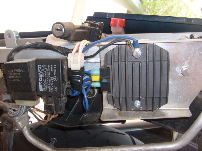

How hot should the VR get? Mine gets really hot.
This is how I installed it. just used the stock mounting plate and drilled a hole in it for second mounting point.
