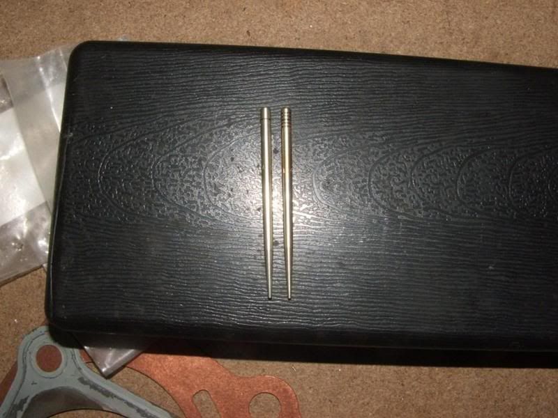

One taper looks like dynojet and the other taper looks like factory pro. However, both have 5 clip positions. Any input? I always seem to get the weird setups. I have needles in my bike right now that look like the factory pro taper but have 6 clip positions. Just wondering which is which really. Not that it really matters to me. I'll be selling both sets.

Either have part numbers / cods on them as one is lean at the bottom end and the other is more of agradual curve thro the range.

The rt hand one is stock needle.The left one looks like dyno jet but your correct it is one adjustment short.Might it be early version of dyno jet???

The right hand one is a factory pro needle.
The left one is a stock needle believe it or not. I do believe it came either some non-US bikes or the Vance and Hines Edition bikes. It is a Dynojet with 5 clips.

That right one is a stock one of a non US fzr600. The left one is an early designed dyno jet. Is the left one something soft like aluminium?
This is a US fzr600 needle and a no US fzr600 needle.

I'm still going with the right one being a Factory Pro one. It tapers off quicker than the one you show at the bottom right.

yea i think your right about the on the right being a factorypro, the taper goes alot longer plus it's not chamfered.
