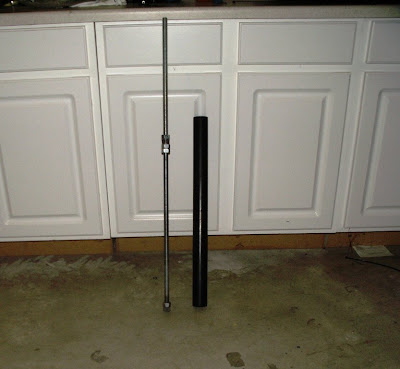

Besides new fork oil that's it. I'd add in the 3ft x 5/8 threaded and 6 nuts as well. You'll need that to hold the damper steady while you loosen the allen head bolt inside the bottom of the fork lower. Also a 1.75 inch (if memory serves) ID pvc tube makes a great fork seal driver.

I'll try to be as enlightening as I can. The bolt in the bottom of the fork is what holds the dampening rod in place. If you were to just try and loosen it the dampening rod would also turn as well-which will work against you and pretty much prevent you from actually loosening and getting the bolt out. You need some way of preventing the dampening rod from turning when you try and turn the bottom bolt and this where the long threaded rod comes into play. Remember me say you also needed 6 nuts to go with that threaded rod? Well 4 of them make up a handle and the other 2 are at the end of the rod and you insert that into the fork and on top of the dampening rod inside it. This will help keep the dampening rod from spinning when you try to loosen the bottom bolt.Cursed94FZR600 wrote:i've been studying that writeup looking for little things i don't understand for a few weeks now and I'm sure i could figure it all out. the only little unclear part was the long threaded rod. the part about that is a little unclear to me. can you enlighten me?
Seen Here:
In the write up that person actually welded a 5/8 nut on to the end of a solid rod stock he had laying around. I didn't have that so I went the threaded rod and nut route.
Here's what my fork tools consist of:
Hope that helps
