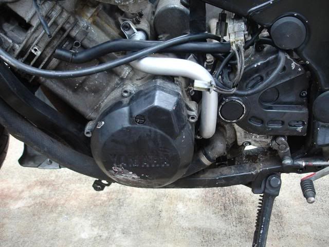

First of all..i have to say that there is no advantage to upgrading to yzf600 covers, aside from getting used parts that are newer. All covers (i haven't got the rear right engine cover yet) fit fine. These aren't stronger, lighter, or better in any way. I just did it because they were cheap, i wanted a newer stator, and my old clutch actuator kept snapping cables because it was hard to move. These particular parts are off of a crashed 04 yzf600. One cover was in really bad shape, so i sanded it down below the scratches and polished it up. But it oxidizes easily now, so i wouldn't recommend that, i'm going to paint over it with aluminum engine enamel the next time i change my oil (which will be soon). I really need to repaint my engine too. Anyway, PICS!

hell , i had a yzf600 stator cover in the garage and been told it didnt fit , sold it to a guy on yzf board for 20 bucks ..
even though they are stronger or better just knowing they fit will make sourcing those parts alot easier for rest of us .
Great Job and Find .. looking good keep up the good work !!! :thumbsup:

Interesting. Have you tried starting the bike yet? I'd bet the peanut cover won't matter, but I too have heard the stator cover can not be swapped. Something about the offset of the stator in relation to the flywheel. If it starts up, let us know and good luck with it.

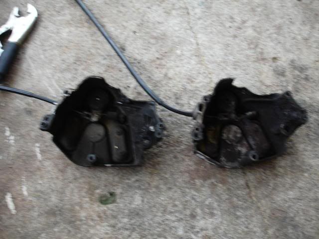

actually i haven't started it yet. I did notice that the pickups are in the same location but the look slightly different and I'm a bit concerned about that. But they are both mounted in the same place. If it doesn't work then i'll pull my pickup out of the old stator cover and put it in this one. I've been using that Kreem stuff to get the rust out of the R6 tank that I'm using in my conversion. The Kreem should be dry now. It's taken forever because of the weather here. As far as the peanut cover..no it doesn't matter, i've been riding around with it on for months. It has a slightly different shape on the outside design, but it is deeper, so it works fine.

I tried doing the YZF stator cover too. Didnt work out all that well because the stator and the coil pickup didnt fit.

are you sure they didn't fit? There is no reason why the stator shouldn't fit. I put the stator and cover on my bike already, everything fits. They are the exact same size, i can understand the pickup not working, like i said i haven't tried mine yet, the pickup looks a little different but its in the same place. So we'll see..

I'd be really surprised if you get it to work. They pickup doesn't line up properly and won't fire correctly.
