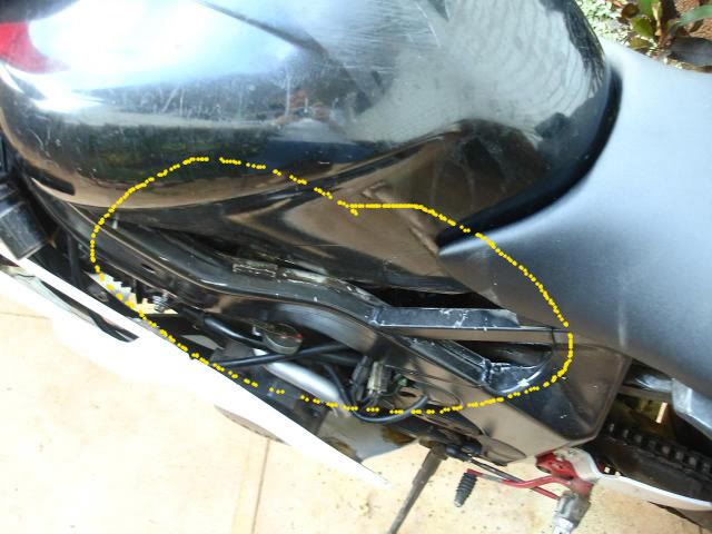

I'm sure the gap in between the gas tank and the frame on the yzf tank is there for a reason, so more air can get into the box, there is a gap in the fzr design too for the same reason I believe.

the gap is there because i'm using a R6 tank on an FZR frame. The frame is wider around the knees on the FZR's than it is on the R6..i have something in mind to make cover the gap and make it look great, but I just haven't got around to it yet. I'll post it when I do.

thats not the same as yours...look at the bottom part toward the right, it has that thing where the tank goes up a little, then back down...I think its for air to flow threw
