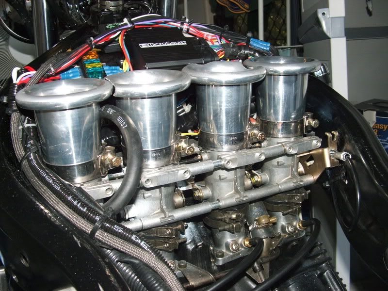

Ok :offtopic: But who says it can't be done on a carbed bike? That's like saying you can't fuel inject a car. A few FZR examples below
Female owned 1988 FZR 1000
Not sure of the year of these but they started their lives as FZR 1000s as well.
If it can be done on a 1000 it can be done on a 600.

Agreed No worries. I was just simply saying that EFI can and has been done on an FZR. They aren't kits either. Complete custom setups. But as you can see it can be done. I myself prefer the carbs (that's until I get tired of them) because it's less work, keeps things simple, and is more fun for me.
yamaha_george wrote: Going on to that 1K with FI did it get ridden and was it far better than a carb 1K?
I don't have any concrete results but i know the black framed FZR1k with the R1 tail is in Germany and gets ridden. I'm sure it makes a bit more power than the stock 145hp with the proper tune on the fuel map but that's only a guess.
