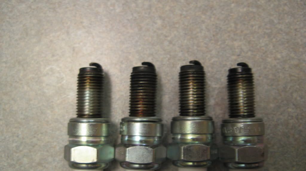

This covers the same problem as the carb thread, but I have a spark plug question.
I changed the gas tonight, made sure the carb boots were on tight the set befor the carbs and after the carbs.
I decided to take her out on a very short run. Well she felt like she was running on only 3 insead of 4. I pulled the plugs, I will hopefully find some replacement in the am. I know that you can tell alot from a spark and how the engine is running. I have never replaced the spark plugs since I have had the bike, almost year and half. So what do the spark plug gurus think from the looks of my spark plugs?
Thanks guys in advance.

Re: Carb question gone to spark plug guru pics
Post by reelrazor »
Too rich.
Post by tkclow »
Looks too rich to me

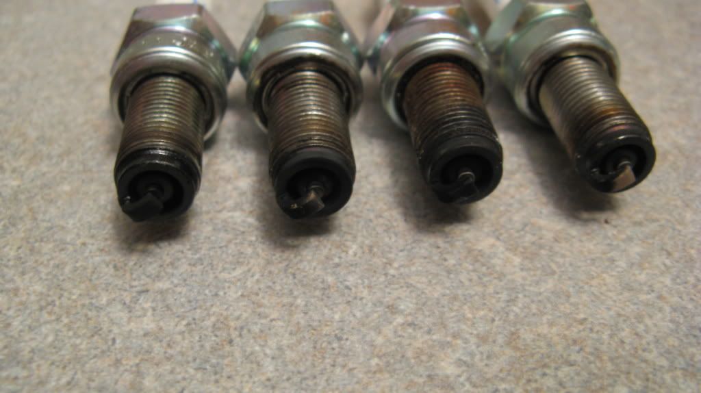

Post by yamaha_george »
ALMOST wrote:Thanks Guys
Almost,
The guys are saying too rich BUT actually that is not saying much as the plugs are too old and used for a GOOD diagnosis as to where the bike is rich.
I can make plugs look like that by idling the bike on choke for too long, idling along at 5 mph in heavy traffic.
Suggestion for you buy precious metal plugs, be sure to gap them correctly (across yours they look to vary, but that may be camera ). Warm the bike up with a ride, then change to one set of plugs.
start the bike NO choke and set the idle leave for 10 mins. pull the plugs and thay should be alight coating that is dark tan not black. You do this thro out the rev range to see the plug readings.
When you test you ride up to that throttle level stay at that level for 5 -10 mins then shut the engine down pull the clutch & stop (called a plug chop ) & check the plugs.

OK who is the wise guy who can tell me what that "indexing" is about ?
Indexing is marking the plug's gap direction and then installing the plug to see which way the gap faces when installed. And then choosing plugs which point the gap in a specific desired direction. Useful in some engines where the plug may be subject to dynamically different 'wash' conditions. It especially pays off in two strokes. Squish banded four strokes also benefit from proper plug indexing.
On our bikes' tight little pentroof combustion chambers one would be hard pressed to find an 'ideal' index, imho.
Yeah, plug chopping is the best way to make a call as far as 'rich' or lean. But, in my experience, plugs that look like Almost's are never getting to their self cleaning heat. He's definately not lean at the middle ranges where most street riding is performed.

as to Almosts plugs one of his plugs is cleaner than the rest in the last pic centre one.............may be newer ??
I was wondering about that one myself. It almost looks as if it is a different brand...seems to have a different ground electrode. I was actually thinking older as the edge of teh center electrode is rounded off a bit more. And it doesn't look as if it was properly tightened as you can see it is discolored the full length of the threads and the other two (? where's #4?) , not so much. It not being able to shed as much heat may account for its' cleaner appearance (getting closer to self cleaning temp).
