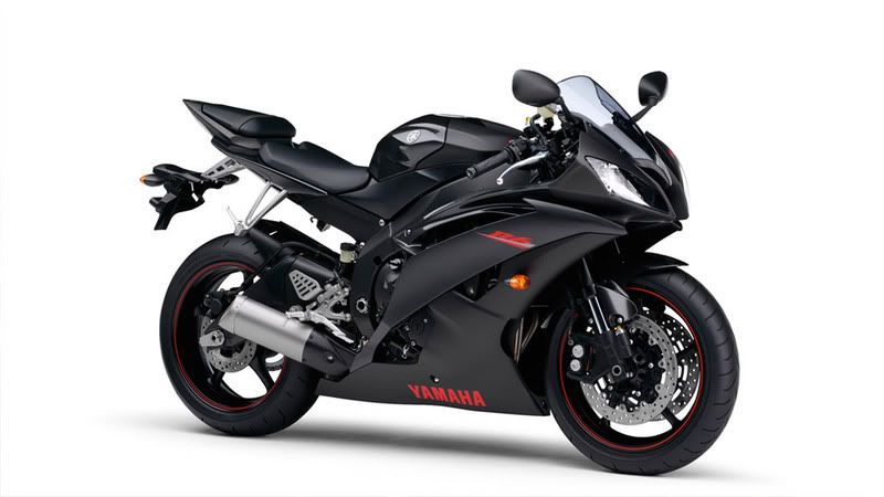

yeah, i just saw your invite to myspace..i don't want to paint the rims all red..i'm planning on this color scheme except i'll have a red windscreen. my rims are already black, and i just shined them up, so it's nice and shiny. I can't wait to paint it black now. I'll just have to find red pin striping.

I would like to get a whole r6 front fairing set and put it on my bike.
Dont put an old style fzr sticker on it. I didnt like the one I my bike that you can see in the picture, so I took it off with a razor.
I also took off the yamaha logo on the tank. maybe find the decal for that R6 and put that on it.
I would also like to get that short exaust can on my bike.
It just sucks for me now because I got to get my bike running again before I continue modding it.
