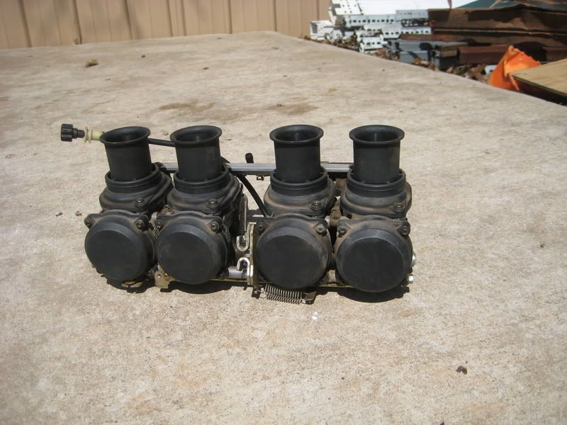

They are actually part of the FZR600 airbox. They are the rubber pieces that attach to the carbs. They are removable from the airbox.dans92fzr600r wrote:So what exactly is this "velocity stack" you had mentioned? And where would I obtain it?
The YZF600 carbs had hard plastic ones like you see in the image below (they don't fit the FZR carbs - just wanted to give another example) ::
