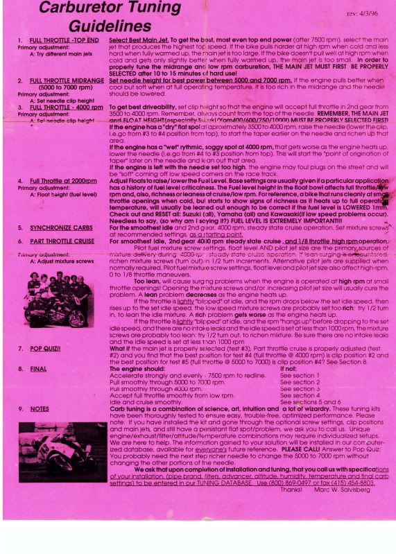

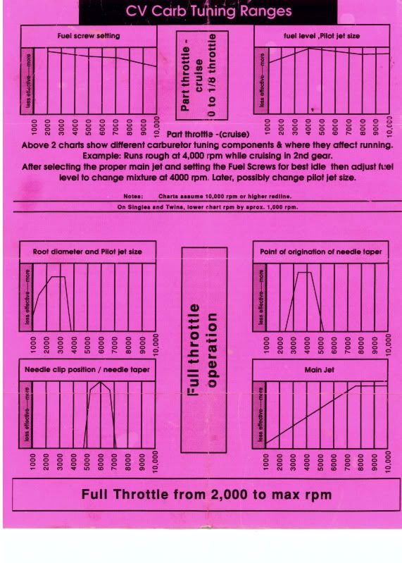

George,
The tape trick is NOT how you tune cv carbs, most of the jetting/metering (eg Main Jets, needle position and float level) is sorted out using full throttle, then the other stages such as Idle and to some extend cruising are metered by the fuel screws .
Read factorypros website here
I used a gas analysis while tuning the bike with the above order of sequence and have achieved very good acceleration from 2000rpm to redline and good fuel economy.
These pictures also explain how each component affects fuelling at each rpm. As can be seen changing the main jet size changes the metering over the whole range but more so at the top, that's why the correct main must be selected first!
Image Image

Dru86,
I do not remember EVER saying that the main jet is EXCLUSIVLY the area for WFO, the charts mearly show what acts where in an APPROX rev range (since every engine is different)
Since the throttle actually operates the carbs its position at what rev range defines what area you should look at in the overall relationship.

George,
you've COMPLETELY MISREAD WHAT I HAVE WRITTEN. Nowhere did i say that you said that the main jet is EXCLUSIVELY the area for WFO, please reread what I have written. The steps that carbs are tuned are explained very well in that sheet that I scanned.
FIRST: the correct main jet is selected by FULL throttle so that the bike pulls cleanly from 7-8k to redline.
SECOND: The needle jet is positioned so that the bike pulls, again on FULL throttle, from 4k to 7ish
THIRD: The float height is set so that the bike pulls FULL throttle from 2k to 4k, float height also affects cruising however.
FORTH: The fuel screws are set to achieve best PART throttle cruising and idle.
The whole reason factory pro give that advice on there site is so that people can tune their carbs correctly, they're not going to sell many jet kits if they don't have any support for their product.
I don't really care what some tech has told you about tuning carbs on some old seca750. What experience have YOU had in tuning CV carbs on a fzr? I've tuned at at least 5 different sets of carbs on both 400s, 600s and my 660 in various stages of tune from stock to slipons, full systems, K&Ns, pods and modified airboxes and have had my combinations checked while using 02 sensors on the street and by having time done on the dyno.
