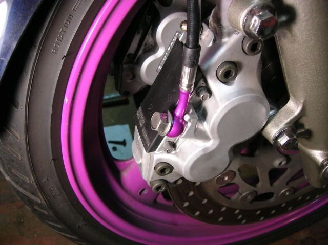

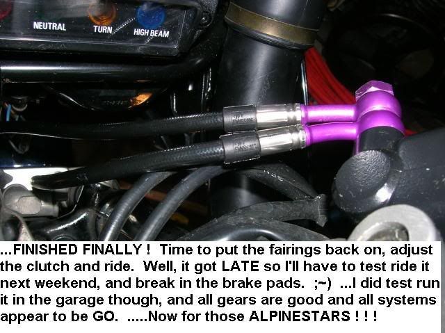

I looked up the Goodridge catalog, our FZR's aren't even listed any more. The other brands I could find in the Dennis Kirk magazine that listed the FZR always had different numbers for the YZF's and R6's. I still suppose it's possible, try them and see.
If not, I suggest Spiegler. You can go totally custom and they take all the guesswork out of it.
On the other hand Goodridge has the "Build a line" method, but you have to measure everything perfectly yourself and you only get to choose between chrome, black aluminum and plain steel banjo ends and bolts.
If you're going to spend THAT much money to replace them, go with Spiegler because, although maybe 20 - 40 dollars more expensive when all is said and done, they've already got it the EXACT length and you get to choose your line color as well as your banjo colors, plus they have custom colored bolts. I mean you could do what I did,
keep the stock bolts (I probably should have spent the extra money on some purple bolts, but anyway...) I got purple banjos all around with black lines to match my bike. You could really go ape-sh*t if you want to. You could have a green line with a red bolt on the rear and red lines on the front with green bolts, or just about any other color in the rainbow.
Honestly, I think it's anodized aluminum and they look really sharp. Anyway, probably the most "professional" looking installation on anything I've ever done in my life. The ends are also very solid, and come with a special plastic twisting tool that allows you to put the end in a bench vise and twist it if you need to.
I never had to twist mine, they came with the perfect angles and positions from the factory.
That said, I hope it works for you, but if not, try Spiegler. (usually can only order thru local bike / accessory shop)
These are some pictures of the front installation- it's a split system from the master cylinder, it also comes with a matching color double-banjo bolt for that connection.
