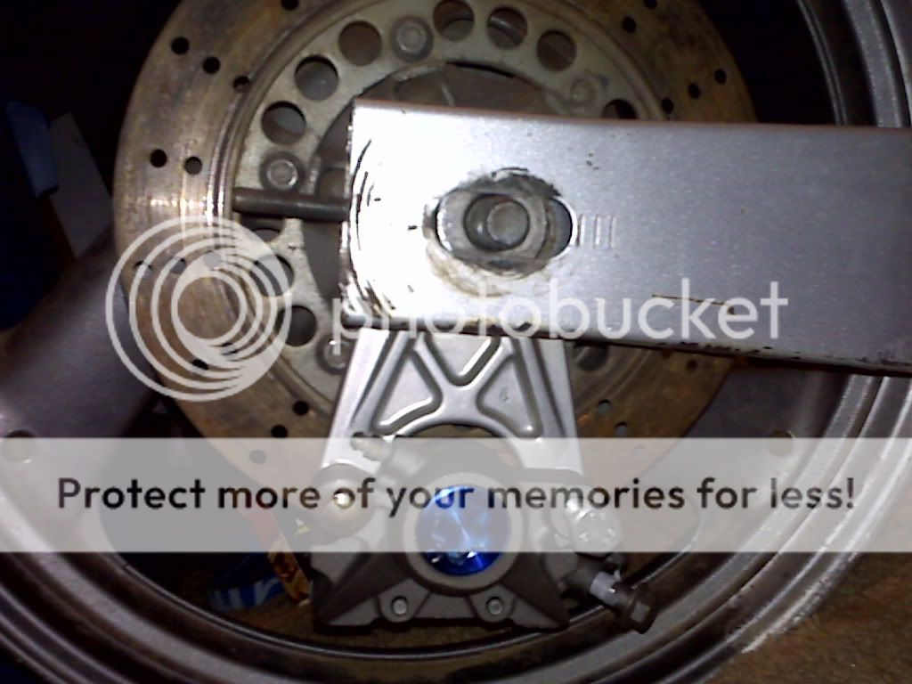

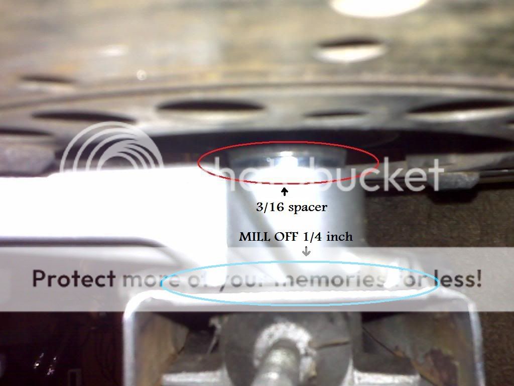

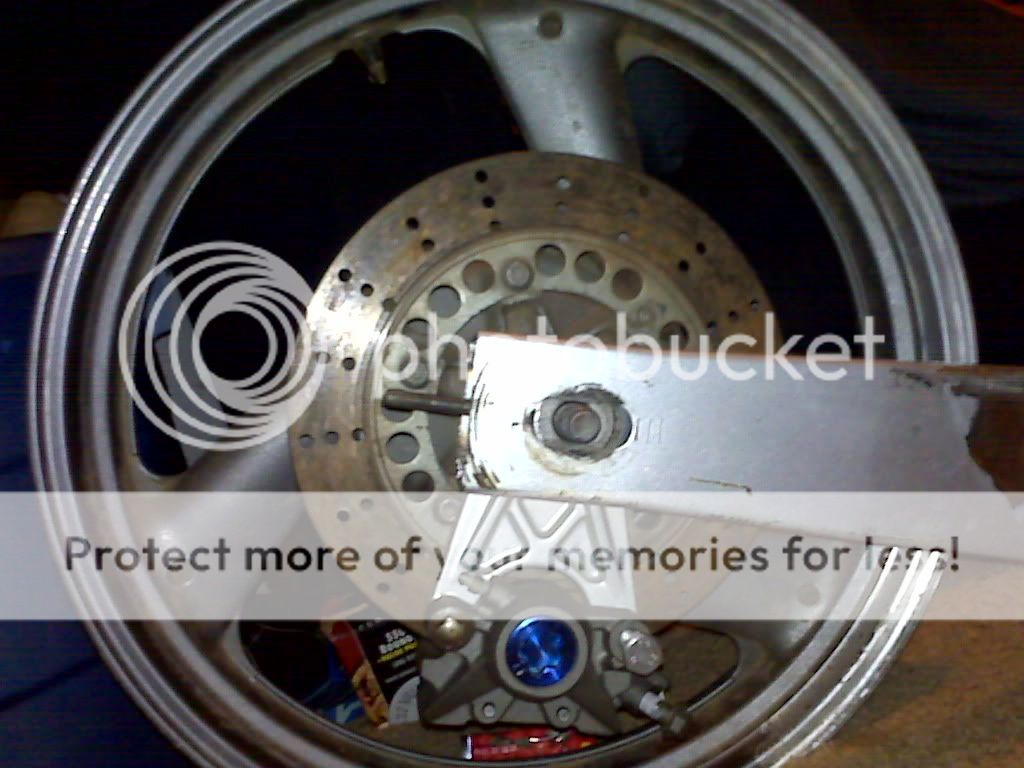

Image ^ were i milled off 1/4 inch and added a spacer^

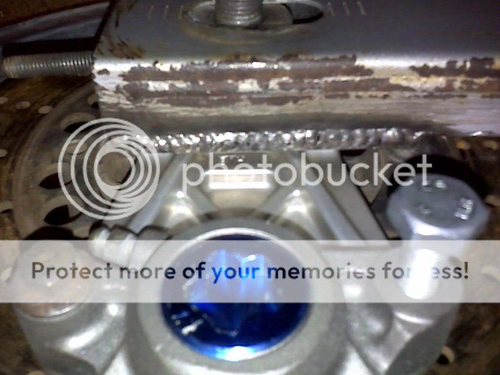

Image ^welded on 1/4 inch flat stock^

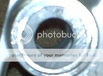

Image ^pressed in bushing^
now all i need is to weld on my braceing and sandblast, powder coat and install :banana:
