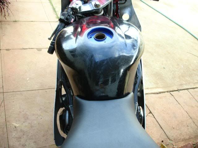

i'm so excited now..i don't have to buy the yzf600 tank for $200 to do my conversion..I can just put the 2000 R6 tank on the bike, the curve on the front of it matches the frame, there is a huge gap (pictured) that I will have to fiberglass over and reshape the back of the tank, but it can be done. the seat fits the tank, it (tank) just needs to be supported in the back..the sad thing is i should have thought about this 2 weeks ago..it would done already and I would be riding the bike around. I've had this tank forever, didn't think I could actually use it on the FZR..

Can you take a few more pics of it from the side for us. Like to see how well it lines up. Thanks!

95FZR600 wrote:Can you take a few more pics of it from the side for us. Like to see how well it lines up. Thanks!
yeah, i just got trigger happy with the camera at 8pm because it fit..i'll take some pics this morning before i leave and put them up later.

as you asked...more pics! in the daylight this time. In the second pic you can see the gap on the rear side of the tank really well. I might just leave it like this. I definitely want to fix the dents in the tank, in the first pic you can see one of the major dents really well, it's the right front side of it.
