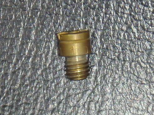

Here's a little more info. I got into the carbs again today and this is what my jets look like. Any ideas what brand they may be, or maybe stock? I know stock for the 400 was 87.5 but I thought maybe the PO got stock ones from a 600 or something...
There's a faint "110" punched in the side, and nothing on the top.
I ordered the DynoJet ones anyway, but it's bugging me no knowing exactly what these are.
