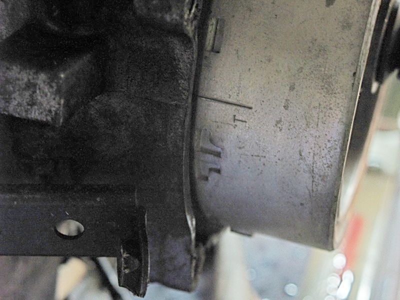

If it was the cams I'd expect it to have picked up by now so just have look at the timing pics below and if that's all ok then I doubt its that.
TDC flywheel lines up with forward crank case joint
Cam shafts timing with Exhaust on the left
ALSO, those cams are a lot different than my 1wg, on of your timing marks is to the right as mine are both upright. I still have the pods because I cant afford a airbox right now and if it ran before okay theres no reason why it shouldnt now but ill see. My main issue at the moment isnt with the carb shooting gas its also more that the one cylinder isnt even firing.
Have a look at that first, mine's a 3tj so a later version (1990) but if the cams are out then that might well be it.

I did check timing and its bang on. Buying a new head is i think too muchEvilchicken0 wrote:OK - have you checked the manual for the cam timing ?snydes wrote:
