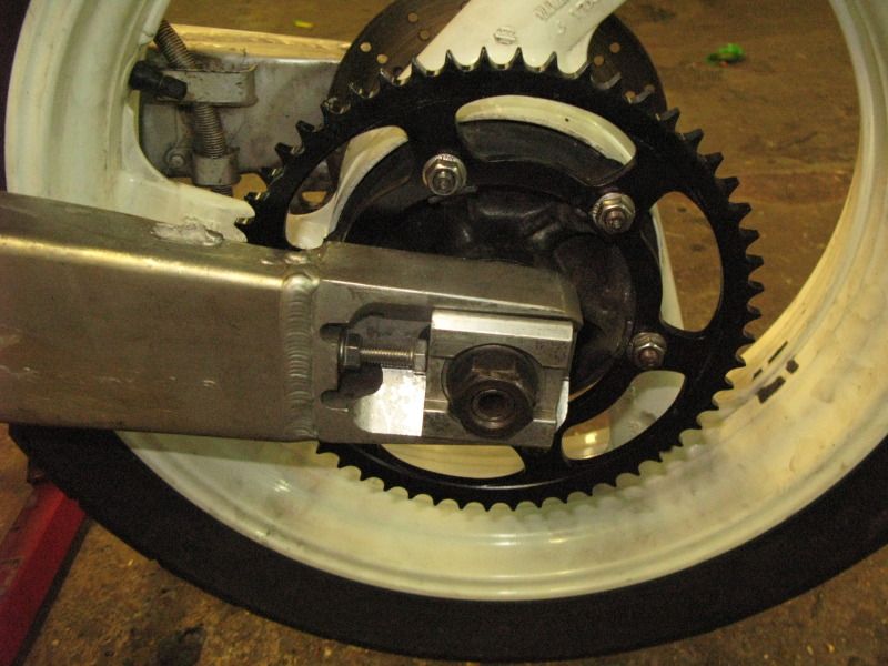

i swill try the r6 brake caliper setup then. its better anyway since im using the r6 usd front setup. Also, i received my 95 fzr1000 rear wheel axle and chain adjusters today. it is a 20mm axle. yaa so 88 or 89+ fzr1000 is 20mm same as 3tj. It is just about an 1 1/2 inches too long to it will have to be threaded further and cut. other than that it is great. i do have another question and maybe someone has a picture of the 3tj rear axle installed. the swingarm slots are larger than 20mm. i was wondering how the stock wheel spacers look on 3tj? cant find a close up view anywhere on net. thanks again guys for your help. great site this is.

FZR1000 axle pullers on eBayDAP019 wrote:the swingarm slots are larger than 20mm. i was wondering how the stock spacers look? cant find a close up view anywhere on net.

This is from my 3TJ project - the chaingaurd bracket had broken off so I was putting rivinuts in the swingarm
When the spindle is torqued up the pressure is taken up through the adjuster blocks, the sloped sides center the spindle which is why the slot doesn't need to be so tight onto it.

ok that clears it up. just wanted to be sure. i like the chain guard bracket mod. cool. the swingarm of mine has the tab broken off of it too. you should remember.
