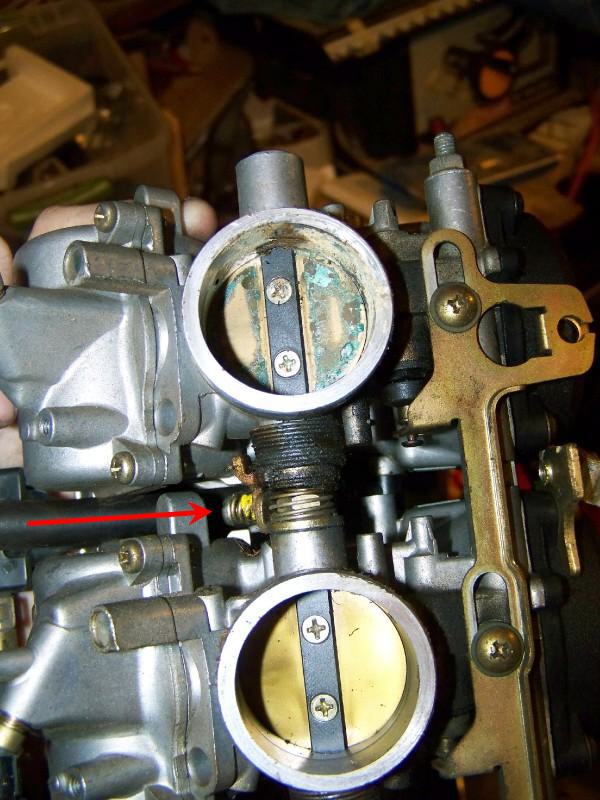

the rpm needle goes from the idle of like 1.5K then jumps to 0 and then jumps to 8K, then back to idle but the bikes actuall RPMs stay at idle...the needle is possest.
she holds idle...if I give her any throttle at all shes goes plump and dies...if I try adjusting idle screw, she almost dies and idle screw doesnt seem to effect idle at all.
if I take it off choke she bogs down and dies....
im letting her run for awhile.
head pipes 1&2 are good around 400degrees, but 3&4 are about 135
im gonna let her cool down then change the plugs in 3&4 and then try again
