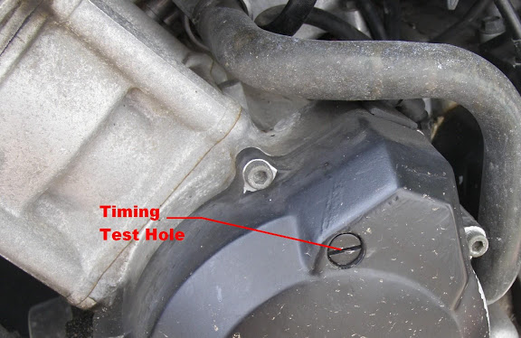

Ever wonder what this screw is about?
It is, as labeled, the timing test hole. Get the screw out.

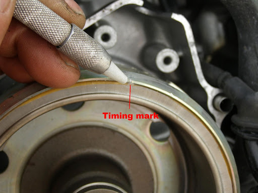

And, highlight the timing mark with soapstone or a sharpie.

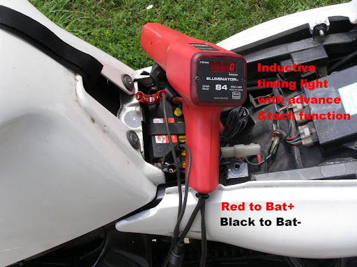

Hook up the timing light (as labeled-red lead to Bat+...black lead to Bat- )

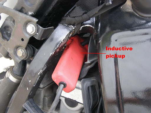

And, inductive pickup to #1 spark plug wire(making sure the side that says "Spark plug side" is indeed toward the spark plug):

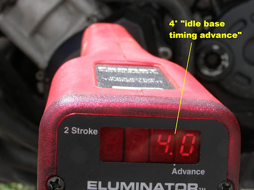

Start the bike and let warm up until it idles nice. Use the timing light's tach function to check RPMs. You may need to switch the timing light's tach to "2 stroke" setting as we have waste spark and on "4stroke" mode it will read double revs. I set my idle to 1400rpm for this test/adjustment.
Point timing light in 'timing test hole'. Add degrees of advance(mine has two buttons..one scrolls timing 'up', the other 'down') in with the timing light one degree at a time, while watching for timing mark. I found it and added advance until the mark was at the very front/left of the test hole. This was 4° and is "idle base timing advance" :
The goal is to increase "idle base timing advance". The factory pro offset key adds 5°.

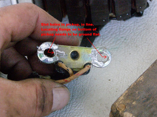

As you can see in the next picture....looking into the stator cover, the engine rotates clockwise. Advance will be counter-clockwise. SO, we want to move the pickup coil left. You can also see that the pickup coil mounting screws(phillips head) wanted to strip-so get yourself two stainless 5mm x12mm allen screws to replace them.
Get the dremel/die grinder out. On the 'back' side of the pickup will be a flange around each mount screw hole. Grind this flush with a larger grinding stone. Use a sharpie and a ruler ..or masking tape to define the 'line' that would be parallel with the edges of the holes. This will be your grinding guide. Grind the holes out to the right (as looking at the back of the pickup). Keep testing the holes for fit with the new stainless screws. You are DONE when the allen head just clears the pickup coil body on the left side of the pickup(looking from the front/near side as installed).
Clean ALL metal filings/shavings from the pickup and stator.

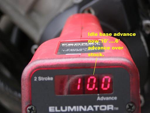

Reinstall as normal(blue loctite on pickup coil and stator mount screws). Start bike and warm up until nice idle is achieved. Adjust to first test RPM (1400rpms in my case).
Use timing light to 'find' the mark...add timing at the light until mark is in same part of hole (in my case front/left of hole).
As you can see....I added 6°to my "base timing advance". FOR FREE. IN 30 MINUTES. It is quite enough to make a difference. The test ride was fun....barely wet roads, wheelspin and lighter front end. :cheers:

How are you making sure the pick-up doesn't move back over? Or is this not a big concern?

cad600 wrote:How are you making sure the pick-up doesn't move back over? Or is this not a big concern?
I doubt they will move, but a set of lock or external star washers under the screws would probably guarantee no movement.
No, not really a big concern. And easily testable(hook up timing light, remove test screw...shoot timing). I've done this(or very similar) on prolly 75 engines (some mine-some customers) mostly on snowmobiles, but plenty on bikes. There's about 8mm of thread engaged on the 5mm dia. mounting screws. Plenty of clamping force compared to the minuscule magnetic field being oscillated by the flyhweel's 'timing bump'.
