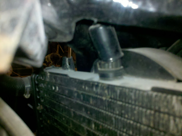

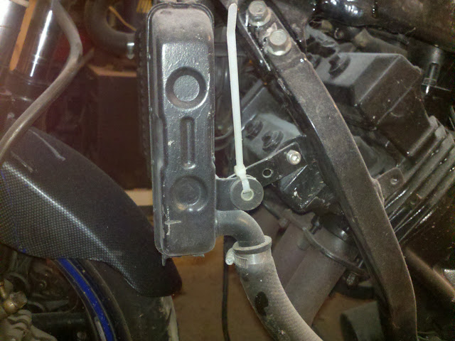

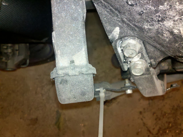

I fabbed a couple of lower brackets, and tweaked the upper mounting point a bit and made the 600 rad work. If i think of it ill snap a pic or two tonight. Not sure how it fits under stock plastics, as mine are anything but.

please excuse the fiberglass dust and zip ties, been doing a little recreating with my bike. anyhow, here are a couple of pics.
still need to tweak the mount a bit more

Re: FZR 400/600 HYBRID COOLING ?
Looks really close to front wheel ? you sure dont have room for a fan do u ?

There is also a mount really low by the headers that you can fab up a piece of aluminum bar to reach down to and connect with the radiator. If you look at pictures of the yzf600r which uses the same outer block cast, you can see yamaha put a factory bracket there while our bikes originally didnt need them. yzf600's dont have the looms though, so theres was suspended. Glad you had some pics on hand though Target. If you need any more help or need pictures of this spot Ill go to my buddies house and snap creepy pictures of his yzf's underparts ... hahah

the fan is on there, works fine. i have the front of my bike lowered a bit also, and dont hit the fender at all.Fzrmike33 wrote:Looks really close to front wheel ? you sure dont have room for a fan do u ?
