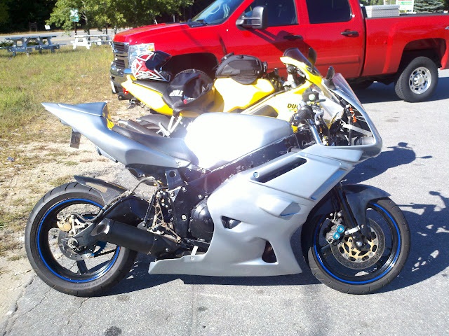

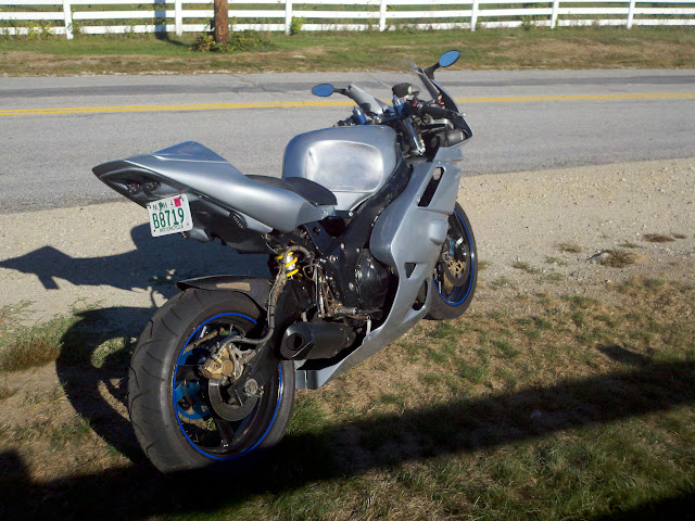

a few of how she sits now, as of saturday. (Tomgun traded up to the Duc in the pic)
What color is it? BMW Arctic Silver.

Whats on the bike?
90 FZR400 frame
94 FZR600 powerplant
TZR250 swingarm, 17" rim and brake, with CF hugger
FZR400 forks with some internal upgrades and emulators.
FZR400 front rim.
R6 can
FZR400RRSP tank
R6 tail(and subframe), with custom cowl, undertail
Ducati upper and lights
GSXR bellypan and original FZR600 fairings molded together and upgraded
Veypor digital gauges
520 chain and sprockets
r6 blue spot front calipers and master cylinder/lever
R1 front fender
ChinaRacer's amazing rearsets
custom dash (work in progress)
steering stabilizer(cant remember brand)
R6 rear shock, custom shock linkage.
