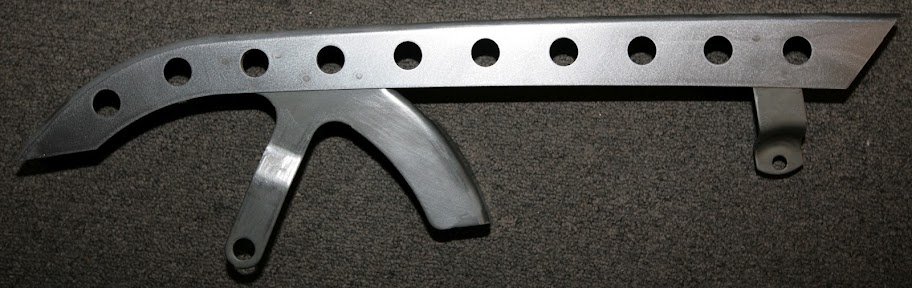

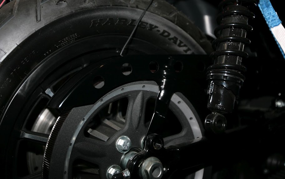

The belt cover taped off before being drilled.
Then I drilled it.
Then I stripped it all down and sanded it smooth. It will get coated gloss black to match everything again.

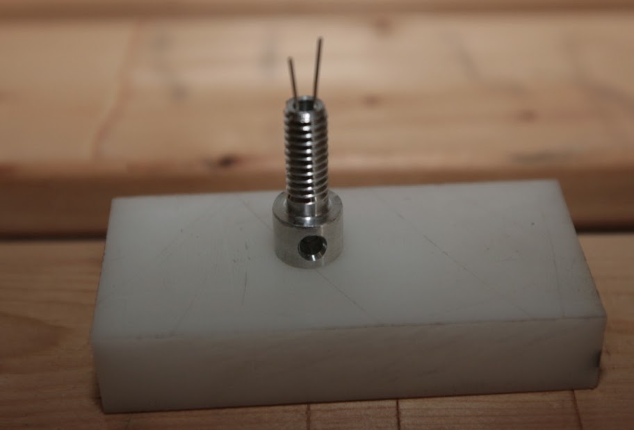

The wee little 3mm led that will soon be going into it's bolt housing. I'd have a picture of it finished but I blew the LED and am waiting on a new one. Sad day.

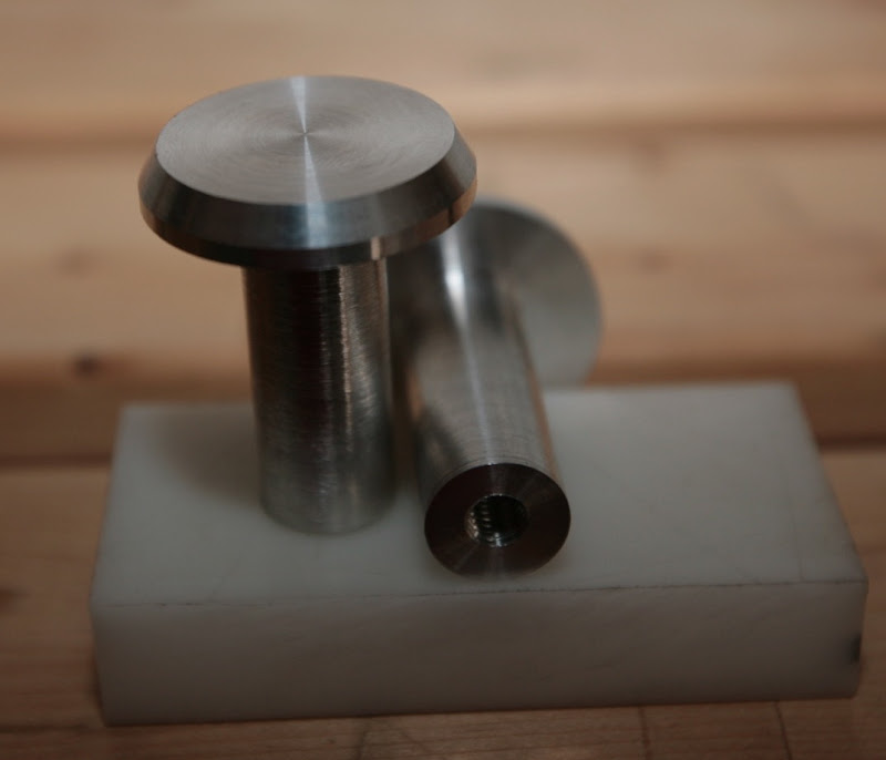

Turned down the edges of the riser plugs.
A peak of them on the bike.

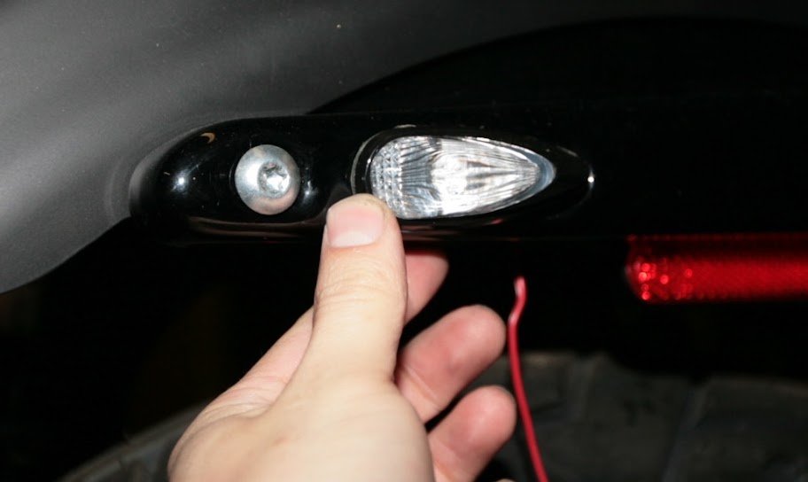

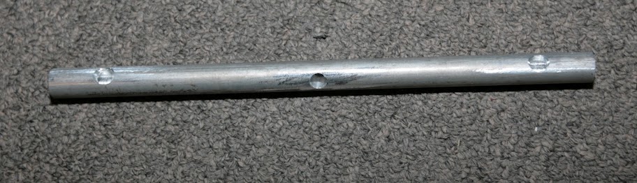

Then I started making a mount to mount the turn signals. I will most likely coat it black but I wanted to polish it up for the hell of it.
Got the new spiegler line installed. I used red banjo bolts to draw the slightest of attention that the line was changed. It will also tie in the red on the rear fender and the side cover.
Placement of the rear signals. Thanks to Andy searching through 30+ pages of signals on ebay, these fit quite nicely.
And I'm torn on the plugs. Not sure I want to coat them black or not. They would live their life unnoticed and forgotten. I might see about getting my logo laser engraved on them, but I'm not sure I have the time to do it. Otherwise, I'm thinking I like them the way they are. They tie into the tank cap I think.

More work. Things didn't go as planned but I guess that's life when doing something custom. My LED light for the rear is finished although it doesn't shine down enough on the logo so it's kind of worthless. All that effort....
Anyhow,

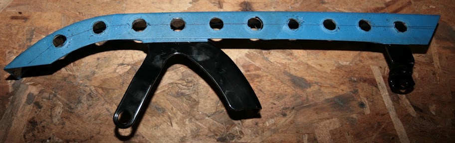

Finished up the pulley cover. I may recoat it in a texture black if it gets here soon enough. It'll blend it better. Also my gloss is going retarded so it has random ripple sections. Not sure why.
The rough outline.
Starting the window.
Getting a shelf for the plex to sit on.
Mounted. You can't even tell there is plex in there!
Coated and finished. You can see the rippling. I don't dig it.
Got the belt guard coated.
A side shot.
That's all. Ordering cables tomorrow and should be able to button it all up over the weekend.

You need to put the LED through the bolt the other way (put the wires through the little side hole first and feed through) so the LED can be pointed toward the logo. Might have to enlarge the side hole. Plus, make sure you have a wider angled and really bright LED.
darrin
thatkid
Posts: 2026
Joined: Sun May 18, 2008 1:25 am
Location: Chicago, IL
Re: A Cafe of a different color
Post by thatkid »
ragedigital wrote:You need to put the LED through the bolt the other way (put the wires through the little side hole first and feed through) so the LED can be pointed toward the logo. Might have to enlarge the side hole. Plus, make sure you have a wider angled and really bright LED.
darrin
Oh I did. The picture of me just dropping it in there was to show the idea, not the execution. It was not an easy fit. As for wider angle and bright, well, they don't really offer much choice in 3mm white LEDS. I'm going to make another one later in the week if I have time and see about fitting a 5mm in there.
