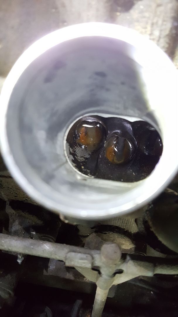

Removed the carbs yesterday and could see some water standing inside.

Took a pic...
Re: Water through carbs
Drained the oil. Got a big surprise...
My drain pan that holds 7 quarts/6.6 litres is completely full.
That's twice as much oil as should be in there.
Oh dear, this is going to be fun... don't even want to know what else is wrong
